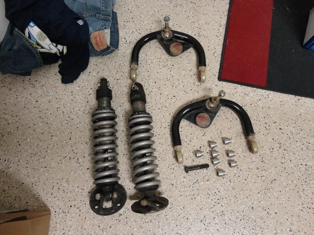

Here's all the parts I have for the front....
http://i953.photobucket.com/albums/ae20/cphillips6480/2010%20Nissan%20Xterra%20SE%204X4/DSC00370_zpsb343ea1f.jpg

When I get back in town on Friday, I will get out all the rear parts and take a picture. All of the rear parts are brand new and as far as I know I have the following:
- Nisstec AAL
- New U-bolts
- Bilstein 5125's
Let me know if I am missing anything so I can start getting the parts and pieces and make some phone calls to confirm with experts.

« Reply #14 on: October 24, 2012, 12:11:45 PM »
I hope your werent taking pictures in the nude with your parts, that's disturbing.  Looks like you've got most of what you need, all I see missing would be the bolts for the top of the coilovers, but those should be easy/not special, 6 bolts, 12 washers and 6 matching nylock nuts, not sure on size or length.
