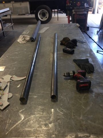

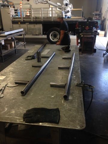

So we started with our material
http://i1322.photobucket.com/albums/u566/SurferXterra/Image11_zpsc1273c92.jpg
Fabbing sliders this weekend

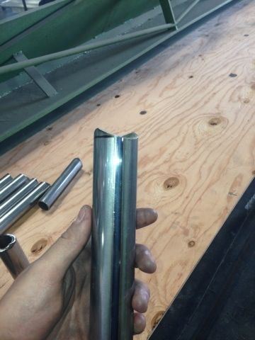

Cut to shape and made some smaller bars and notched them:
http://i1322.photobucket.com/albums/u566/SurferXterra/Image10_zps195cbe35.jpg
http://i1322.photobucket.com/albums/u566/SurferXterra/Image9_zps26eb8010.jpg

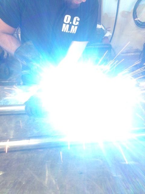

Then we tacked welded them

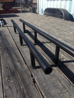

Cleaned them up and finished welding them then sprayed them:

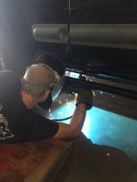

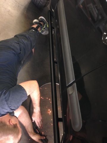

Everything looked straight so we finished up the welding:
http://i1322.photobucket.com/albums/u566/SurferXterra/Image2_zps55dce564.jpg

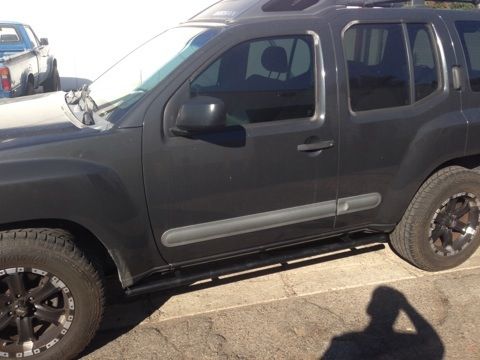

And voila, we are done:
http://i1322.photobucket.com/albums/u566/SurferXterra/Image_zps9ba9c3af.jpg
I am pretty stoked with how everything came out. They are welded directly to the frame and made from 2" steel. Super strong. We own a sign company so we got to use a lot of the equipment. This weekend I will be lifting my truck (PML, spacer lift) then the next mission is to fabricate a rack.
